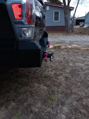

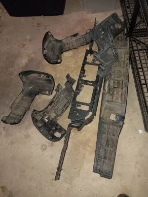

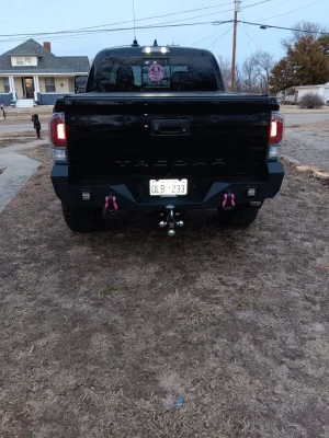

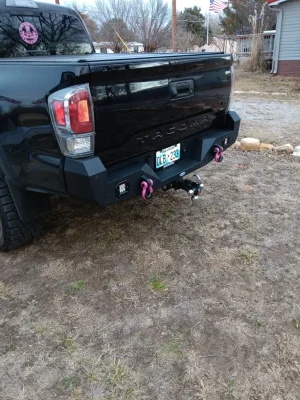

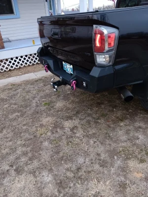

I installed a quarter inch thick steel plate bumper from Hooke Off Road and during the dismantling of the stock bumper which is 85% PLASTIC and 15% thin as tin metal makes me think OMG a good accident from behind, I could meet my creator.
Rear end me now and your on your way to the hospital.

Love the bumper! Front and rear bumpers are definitely on my “must haves” upgrade list!
Vehicles today use the collapse / crush method to lower passenger injury.
They are not as concerned about vehicle damage,.. as 90% of vehicles today on the road are made with the same method.
Aftermarket bumpers maybe strong but it can only hold back what the frame can support.
Think of this,... with 25 pounds of force you crush an aluminum can on your head.
The can is smashed and you may have a cut or bruise.
......... with 25 pounds of force do the same motion with a hammer to your head.
The hammer is undamaged but you most likely will die.
Unless the entire frame work is as strong as the bumper you gain only bumper protection.
The rest remains the same.
Very true. But I would imagine the frame is much stronger than the existing bumper, were it not using the crush method. Meaning that I would still prefer a much better, much beefier bumper upgrade (like the OPs), thus protecting the occupants as well as the truck itself.

Im brand new to Tacomas so pardon my ignorance…is this an add-on part to supplement the stock bumper/hitch?
They have it labeled as a Reinforcement Sub., Then there's 2 different variations. One has the hitch received and the other is plain. It might just be the 4 cyl and low models that don't have the tow package. Wonder if the non tow package ones have the plain bar or if it's just left open.
Part 6.
Basically closes off the end.
